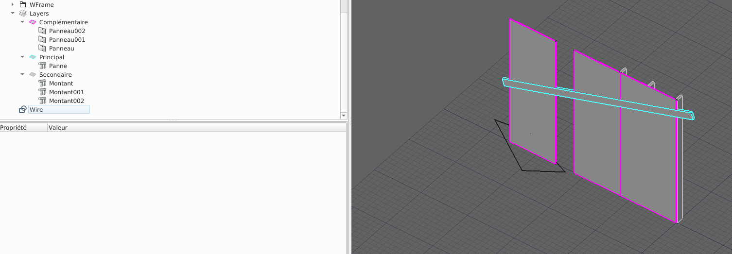

Hello I’ve made some screenshots :
Here is my 3D view :
if I generate view I have good hidden lines job ! but no line color :
Finally if I export to dxf, this is what I have, only one layer called “view”, no hidden lines separation:

this is what it generate, all layers are created, but I’m unable to calculate and separate hidden lines
Édit: I think i have to work with viewobject, and not Shapes object
