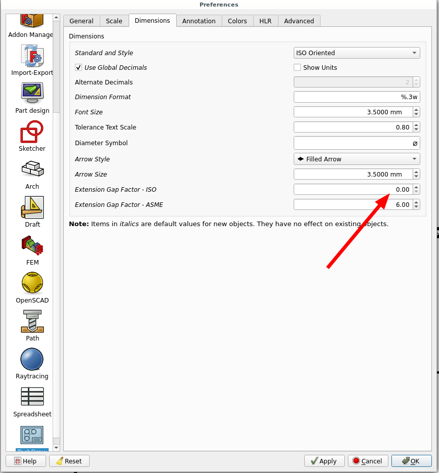

I made a few drawings and stumble across the new feature. The ISO has as default no gap, it should be per default 0. (Never saw in my life a gap between).

A second thing, which i noticed: the settings in the preferences seems to be ignored. When the setting is 0 (or any other value), the dimensions have still the value 8.00.

My bad. The preference is “ISOGap” in one place and “GapISO” in another. The fix will be along shortly.
If the code doesn’t find “ISOGap” it uses 8.0 as the default.
Thanks for finding this.

Preference should be fixed by [commit]5d93fbe0bb/commit].
Works, thanks!
