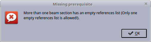

Hi all,
how can I define different beam sections for different lines?
I’m only able to define 1 type and if I try to define two, selecting one at a time, I get the error message when I run the analysis
Enclosed, the test case I’m running
Thanks in advance.
exampleTwoBeams.fcstd (11.5 KB)
works great here if you add a reference to both objects …

I asked for help and I got it, thanks to Bernd for support.
In fact it was only a question of checking the analysis settings once more.

BTW, if you set 3D output to true you gone see the different size of the sections. You do not even run an analysis for this. You could use the check analysis type for this. But you need an up to date FreeCAD and you need to add a new solver.
