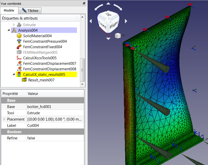

I want to estimate a deformation under pressure of a box. This is a quite simple problem
As you can see the deformation is around 9.14mm. A real life trial give me 8mm. (perhaps it’s not so bad for FEM)
Then i cut my part to decrease mesh size and time for calculation
Then the deformation is 12mm.
Question 1 : How do you explain this difference ?

I can’t see a noticeable difference
Changes:
  • reduced max elem size to 3 mm
  • corrected sym face constraints
Please note:
On sym faces deflections in plane are allowed (translation and rotation)
deflections out of plane are forbidden :wink:
So please don’t forget the rotational DOF’s :unamused:
box_under_pressure_no_mesh_ur_.FCStd (53.2 KB)

If i understand well : When you have a symetrical plane, you need to block rotation on the other axe.
But what do you mean exactly when you add “(translation and rotation)” Did you only describe delflection ?(My english find its limit)

Rotational degrees of freedom need to be set properly for symmetry BC for beam and shell element_s. In ccx, solid elements do not have rotational DOFs, so if you run UR’s example you will get exactly same results as if you let rotations to be free at boundaries.
try to imagine solid elements on the boundary - rotations are constrained since solid elements have 2 nodes through the “thickness” on the boundary cross section. Whereas shell element has only 1 original node on the boundary cross section curve, so you need to prescribe the rotation constraints.
Explanation e.g. here: https://www.clear.rice.edu/mech403/HelpFiles/CW_sym_anti-symmetry_BC.pdf
The non-linear analysis calculates several iterations and after each iteration it updates loads acting now on the deformed mesh (and material if you define non-linear material properties). Thus it is more precise in case of large deformations.
