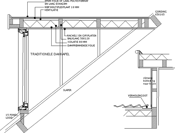

What would be the best way to detail some of my windows (currently ‘Arch Windows’ ) using the ‘real’ aluminium profiles in the full model of my house? I like to create detailed drawings for some relevant sections and end up with something like this:
I found some dxf files that I converted to freecad (see attached file) and was trying to make a full 3D window using the PartDesign_AdditivePipe feature but so far this only results in very complex models and I guess I am probably completely on the wrong track. I figured that this probably was not possible using Arch Windows and hoped I could create something with Part design (possibly parametric) that I could fit in some existing openings. I looked through several example projects but could not find any good example, however I did some some nice screenshots where people did this. Any ideas on what the best way forward is?

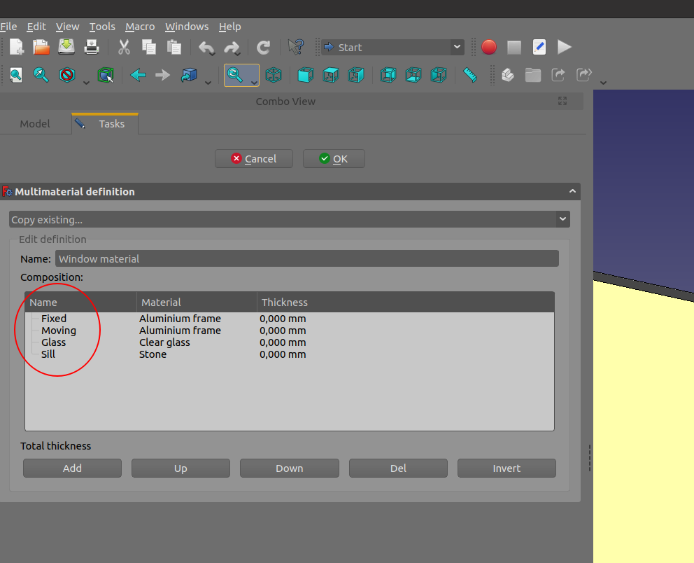

This work around works fine - this is really a powerful way to configure windows! There is so much info in the wiki pages, even after reading it 3x I still find useful hints and tricks. I managed to create windows, put them into walls, I can easily move them around and even create some nice techdraw pages, see attached example. Just struggling with the last steps;
  • making the multi-material work. I compared my models with the example one, where everything works just fine but without any luck so far
  • finding a way to use a single base window and scale it to fit the different scales for different windows in the building

@Paullee, tried again yesterday evening by renaming a ‘standard’ window which works fine. Then I tried renaming some of my components with similar names like the standard window (Glass Panel, Frame etc.). Probably some very stupid detail that I miss somewhere.. will try again with a new custom window from scratch since I compared about everything between my and Yorik his model. Is there an easy to export all (hidden) properties and features of an object (possibly using python) so I can easily text compare to spot differences?

Did do a new attempt, this time taking the example model, just replacing the sketches with my profiles and re-creating the sweep. Strangely enough the materialization worked, but for only one profile. Changing the aluminum color was nicely propagated to the windows. But after saving the file to upload it here and re-opening again, it does not work anymore (only for the Sil it works, but I did not touch/destroy :laughing: that part..)
The only clue I have seen occurring multiple times that indicates something is wrong is this:
Part::FeaturePython / Window: Links go out of the allowed scope
Some day it feels like I really start to master some parts of freecad, other days all this struggling make me realize there is so much more to discover :wink:

And hmm… this wiki reads -
"To build a material for type-based windows:
Create a multi-material
Create one entry in the multi-material for each component of your App Part. For example, one “Frame”, one “Glass panel” as we used above. Make sure to use the exact same name.
Attribute that multi-material to each of the windows derived from the same type
You can use any other kind of workflow than the one described above, the important points to remember are:
The type object must be one object, no matter the type (App Part, PartDesign Body, Part Compound, or even another Arch Window)
The type object must have a “Subvolume” property (linked to the window’s Subvolume property) for openings in host objects to work
The type object must have a “Group” property with different children with same names as multi-material items for multi-materials to work "
jep, I read this section several times to figure out what I missed, and always assumed the ‘group’ property referred to this:
and that it should match the material names used in here:
But maybe I am completely wrong. Is there a way to export all (hidden) properties to a text file of an object?
Just realized that in the previous attempt (based on the wiki file) I forgot to connect the right object to the ‘subvolume’ definition of the type, but that did not change the results..
It seem somehow it works on the “Sill” and “Clear Glass”, but not on the “Fixed” and “Moving”.
