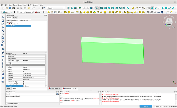

Can't import multilayer walls as parametric arch objects
Hi!
I have a fairly straight forward IFC demo file, that I try to import into FreeCAD: https://friends.ccbib.org/lambda/EFHeinfach06.ifc
However, if I try to import with standard settings, I get this error output for each outer wall (made up by a concrete layer and insulation):
    adding 2 object(s) to Wand-003
Width & OverrideWidth & base.getWidths() should not be all 0 or None or [] empty list
Fehler: Ungültiges Basisobjekt
3D-view is missing these walls and the room objects are also displaced. See the attached file.

That’s a regression introduced likely with @paullee’s extensions. Arch Walls SHOULD work even with Width & OverrideWidth & base.getWidths() not be all 0 or None or empty list. I’ll have a look at it
EDIT no, that error message shouldn’t be printed ( 146a175370) but it doesn’t modify the wall functionality. I’ll have a look at your file…
Okay there was indeed a regression there, the wall object was not working anymore when made of aggregates of other objects, this is now fixed in 6945e37635.
Strange, it looks like all the walls from this model were made this way… I had never seen such an IFC file before. This is from ArchiCAD right? We get too few ArchiCAD files to test around here, please submit more if you find other issues!
Thanks for the quick fix! The wall objects work now, though the messages during importing persist. Also the space objects are still placed incorrectly.
