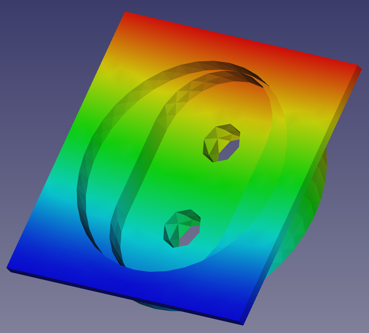

Calculix *ERROR in e_c3d: nonpositive jacobian determinant in element 37091
So I keep getting this error in some models persistently, and I have now an eye for identifying why. However I still don’t have a good way to resolve the problems.
https://forum.freecadweb.org/download/file.php?mode=view&id=144462
In this case, there seem to be a cylindrical surface tangent to another surface. My guess is that the triangulation tries to continue with flatter looking triangles until it can no longer do so. Probably the surface turns inside out or something at a small scale and that’s where the error comes from?
No idea. But I know that if I remove that feature, then my analysis will probably run. I am wondering if there is development in GMSH or netgen or calculix to somehow fix this problem. maybe by giving the user suggestions on how to fix it or identifying the problem in the mesher and changing the parameters some how?

Now that’s interesting. Using the same GMSH that is supposed to be used by freecad, I get no errors about jacobians. I basically exported the step file that I attached here earlier, then opened it in GMSH, I took the defaults but changed the mesh size to max 1mm and hit the 1D,2D,3D mesh buttons. Exported to UNV and imported that into freecad. Not only was it really fast, but no jacovian errors.
So I don’t understand what is happening. why does getting the mesh from GMSH in freecad take way longer? Why do i still get the jacovian errors using GMSH from freecad but not manually? very weird. Is there a settings file that everyone is using which I don’t know about or something?https://forum.freecadweb.org/download/file.php?mode=view&id=144470

there should be no difference between gmsh in FreeCAD and stand alone gmsh, if exact the same paramter are used. You can even do what FreeCAD does … What the report console during meshing. The file path of the geo file is printed. Open this geo file with gmsh will do what FreeCAD does.
I have seen meshes without nonpositive jacobian in gmsh but ccx complains about non positive jacobians and the other way around. Gmsh complains about nonpositive jacobians and ccx does not.
The best what could be done are:
  • use a finer mesh
  • set the parameter Second Order linear to True in FreeCAD gmsh object
Ahh welcome to FreeCAD FEM
cheers bernd
We should may be start a wiki page about the nonpositive jacobians, as they are the most often seen problem in FEM which is sometimes not easy to solve.
How would I set the parameter that you mention below from freecad?
Here is a file with the FEM setup which is just there to have calculix run.
https://forum.freecadweb.org/download/file.php?mode=view&id=144497
In the file I include a mesh that was created by the internal gmsh and another by the external gmsh. take a look. The internal one is only slightly different in how the triangles are arranged.

did you know … FreeCAD does show you the problem elements if the run button is used …
here is what the FreeCAD gmsh call for your mesh is look like. As said it is the geo file printed in the report console

ATM it is only you who knows what mesh parameter where used in gmsh on manually meshing.
BTW:
  • If “Second Order linear” is set to True in Gmsh mesh object in FreeCAD there will bi no nonpositive jacobian. :slight_smile:
  • might be this is set to standard in manual gmsh run?
A mesh region does not help either … the problem resist on the same place. It is because the edges results in zero distance but gmsh does not repect element sizes on this. Netgen is much better here.
But as said I would just use Second order linear parameter and use no mesh region in this case.
test_meshregion.FCStd (15.4 KB)
but how do I set the order to second order from freecad??? I think I know where to do it on GMSH manually, but not on freecad
“Second order linear parameter”
Ah, you mean with the internal Netget mesher? yes that was set to 2nd order. the internal GMSH mesher doesn’t have the option.
no matter which mesher I would use second order elements for this anslydis.
The parameter “second order linear” can be set in the attribute editor. Click on the mesh object and on the data tab and scroll down.
The psrameter uses straight second order elements.

JWorks Bernd is not active here anymore. Negative jacobian locations will be highlighted when you try running the analysis using the default solver FEM SolverCalculixCxxtools and FEM SolverRun button.
Tips on how to get rid of those errors can be found here: https://wiki.freecad.org/FEM_MeshGmshFromShape#Nonpositive_Jacobians
