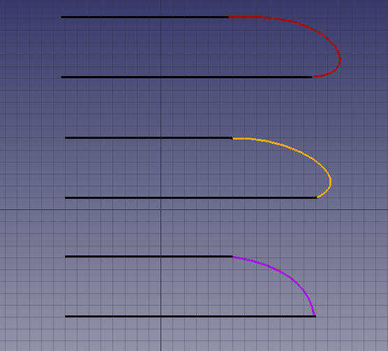

The degree of the Bezier is one less than the number of points, so if the user clicks 5 times, he or she will get a curve of degree 4, which is two end points and three intermediate points. I think in most cases, the user would not need degrees larger than 4, which is why quadratic (2nd degree, 3 points) and cubic (3rd degree, 4 points) Beziers are so popular in most drawing programs.
In this picture, from top to bottom, the two lines are tied with Beziers of degrees 4 (quartic), 3 (cubic) and 2 (quadratic).
Instead the user should set the curve degree before starting the creation and it should remain fixed for the whole curve.
