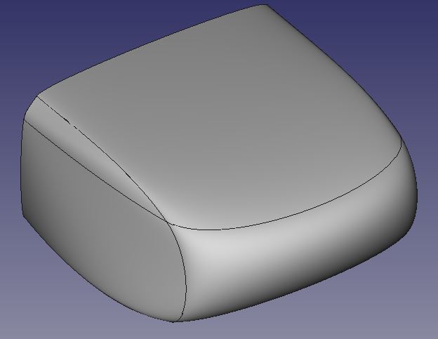

see below: Part workbench surface from edges above, and my scripted surface below. No efort to go beyond G1 here, just a test file

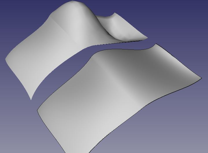

a more dramatic comparison of default behavior. Note the curves are fully 3d, not just planar; there is no way to create non planar curves in the UI though.
Here you can see really well that the surface is G1, but the curvature discontinuity really jumps out.

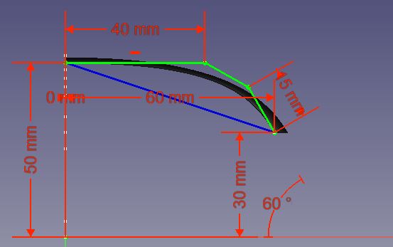

UI workflow:
sketches of three line segments. note you have to match all corners by hand, because of sketch linking restrictions. This prevents me from doing anything really interesting, but Deepsoic/ new part design is going to fix that real soon
make cubics out of the sketches
cont.

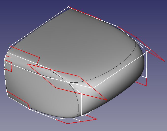

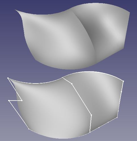

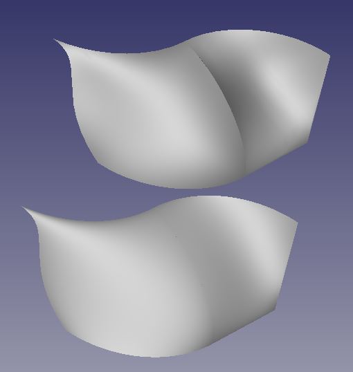

when you have enough curves, make a quick visualization of the control patch. This just show the control points that will be used in the patch. If the polygon looks ok, make a patch.
here you can see my next todo: make better three sided patches…this one is really crappy :slight_smile: in the last pictures, you can see G2 coming down across the front…and the serious problems on the top left transition triangle
