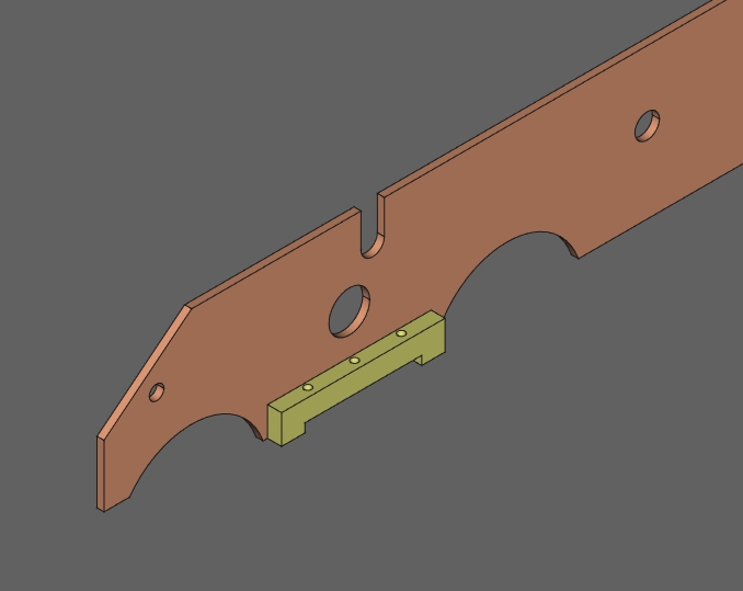

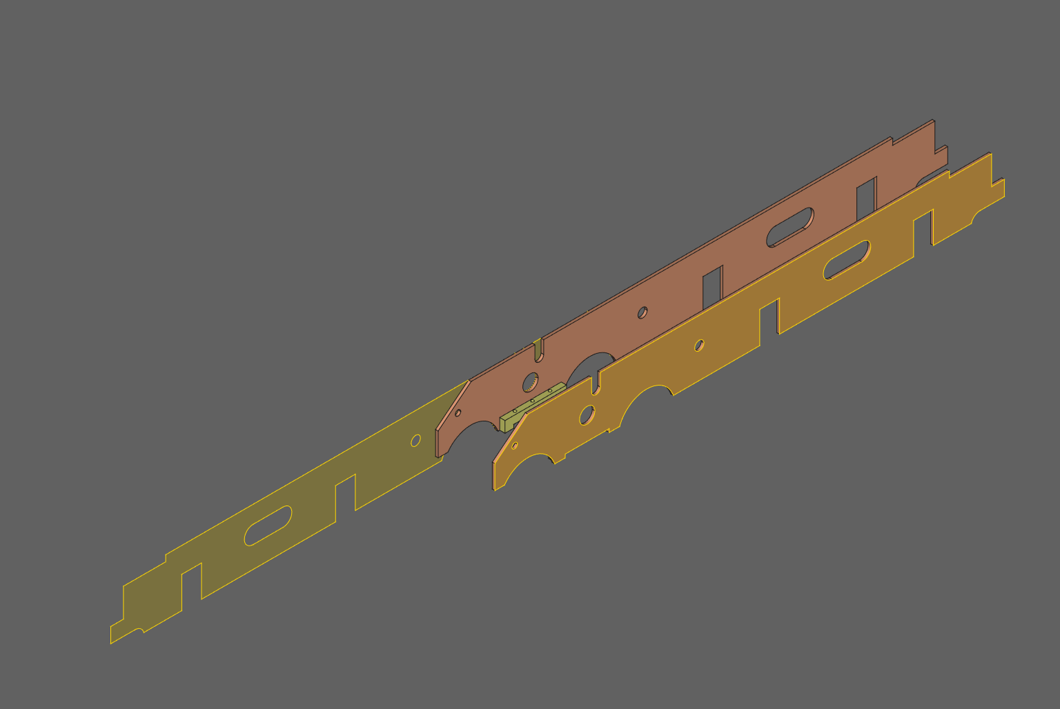

I have two parts that I want to constrain using “Attachment”
I select both:
and click on “Attachment constraint” and… things go funny/weird :mrgreen: :
If I select two parts in different order, it is the same (apart from different part moving :neutral_face: )
Why is it happennig? (or what am I doing wrong?)
What can I do to correct it? please

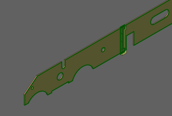

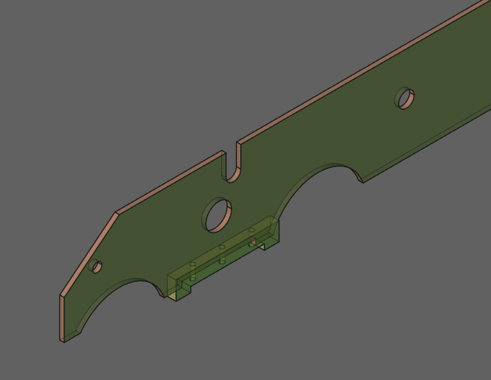

Yes, something weird is going on with shapebinder :unamused:
Two faces out of one body?
It must be to do with the fact that one of the two frames (RH) is the link to original (LH).
Originally one was mirror image of the other, but I tried to do things Assembly 3 way (i.e. using link)

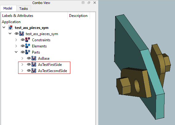

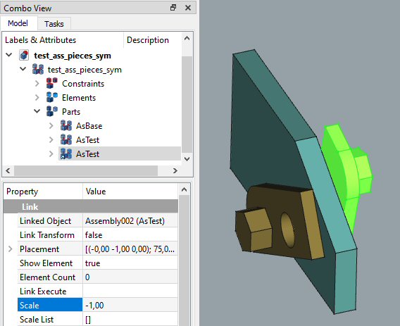

I’ll see what I can do. In the meantime, I tested @realthunder’s suggestion to link on the starting part and then set the scale parameter to -1.
I totally couldn’t understand this scale business - now it is all clear :stuck_out_tongue: thank you!
This is the easiest and neatest method - I like it, but…

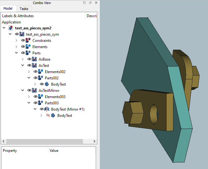

I admit that I did not understand everything either. I tried … unsuccessful.
Only this solution with the PartMirror function worked :
Before creating the assembly containers, I created a PartMirror of the BodyTest object.
Then I encapsulated BodyTest in its AsTest assembly container by defining its constraint elements.
Then BodyTest (Mirror # 1) in its AsTestMirror container with its constraint elements.
Finally the general assembly and the PlaneCoincident constraints of the 2 symmetrical parts with the central part.

I see what you have done, but … have you tried elements and constraints ?
I think you will find it is a problem, because of what realthunder explains:
…Part Mirror (or any Part feature for that matter), will take account the child feature placement, and adds its own placement on top of it. So even if you move out the assembly as shown in the above screen cast, your assembly will not work. Because moving the non-mirrored body will indirectly move the mirror as well, which will confuse solver for sure…
and that was my experience as well :blush:

Had a good look at both files and:
the first one test_ass_pieces_sym.FCStd (where you use link at scale=-1) is the cleanest one and my preferred one, although I tend to rename things so that they are less confusing :wink:
the second one test_ass_pieces_sym2.FCStd (where you Part mirror before using body in assembly) is very messy (to my mind) with having to use three bodies for each mirrored pair, and whilst manageable for simple three part assembly, it would be challenging for my designs where there are very many mirrored parts.
Plus, I remain concerned about realthunder’s comment (and why does he say so?):
…It’s usually not a good idea to mix Part and PartDesign feature, especially when coupled with asm3 here…
I also think this is the easiest solution, and nothing stands in the way of renaming the component to negative scale.
one of the “three” bodies is just a reminder of the original mirror component:
Above all, I think that you have to be attentive to what you are looking for and the results obtained (but I do not know what it means precisely).
