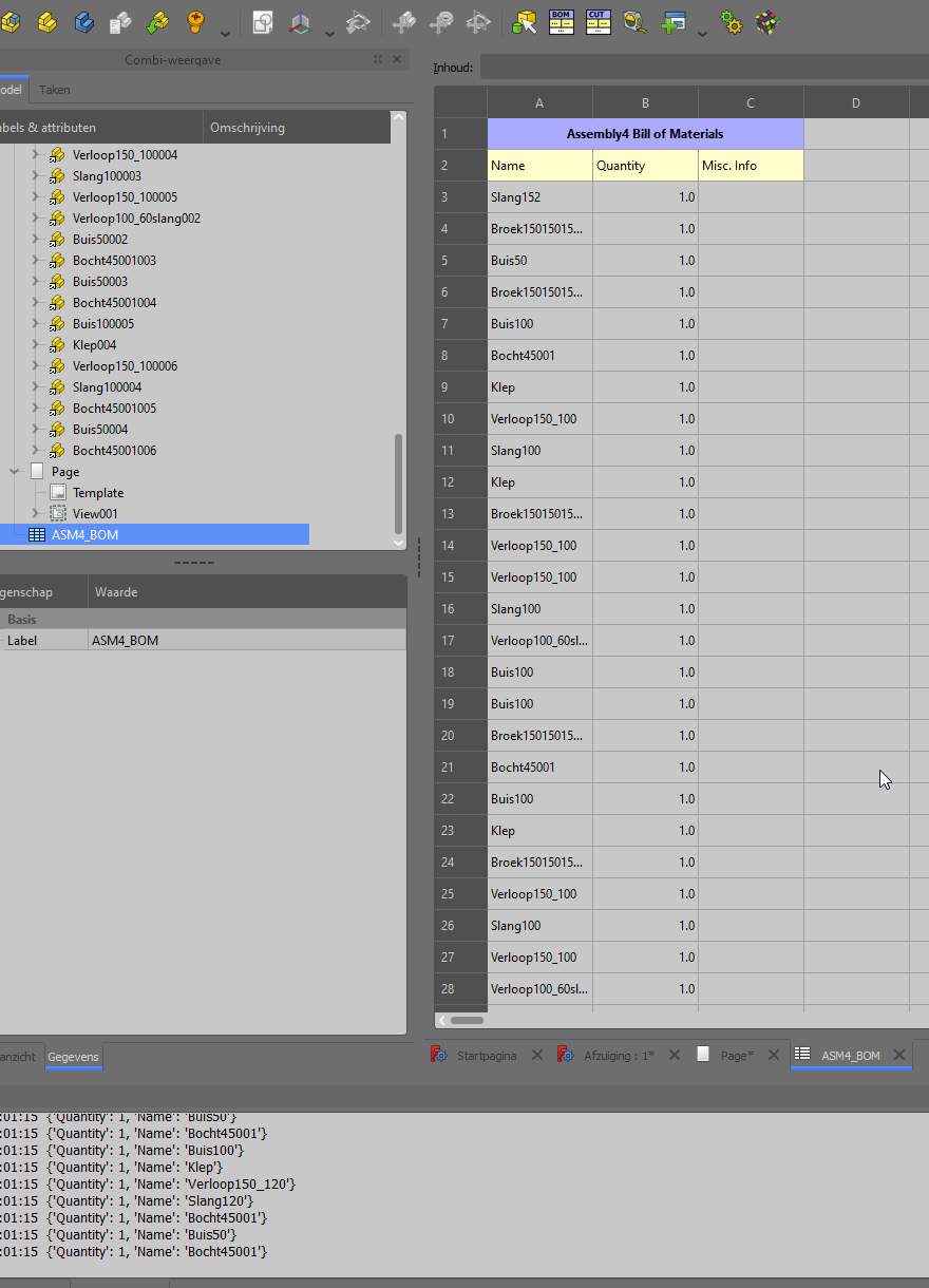

I installed the modified workbench and below is what I found.
The edit part produced an error and I did check what went wrong, see 3rd screen.
The BOM worked after I commented out 2 statements at the end, see attachment of makePartsBOMsheetCmd.py and 2nd screen.
The BOM does not add the same parts to one row with the right quantity yet.
I modified the BOM sheet to produce a 1st version of a Cut list, see 1st screen, works fine with the same restrictions as the BOM.
Hope this helps.
makeBomSheetCmd.py (9.15 KB)
makeCutSheetCmd.py (6.54 KB)

Alex,
Just found out that infoPart did not work because I used an existing A4 model, where the RequiredPartMetaData doen not exist.
It would be nice when the software can handle that case.
Herman

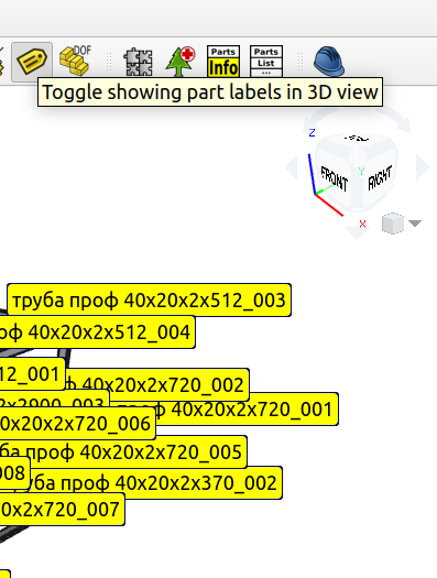

If it will work - FreeCad could become very useful tool for a real production. One of the biggest request from customers - “how much materials does the product contains?” For example, furniture & interior production implies one-type objects, with the same structure - Asm4 - is an ideal instrument for joining hundreds of such objects in one assembly! A2Plus can not include so much parts as in usual production is needed (I’ve tested it with some metal frame and got the legendary “topology naming issues”). So the BOM of ASM4 - is a very needed feature!!
Here’s an example of the steel frame, I’ve don in A2Plus + TechDraw. (overall view with the part’s names I’ve made from a screenshot of A2Plus assembly with labeling feature enabled and pasted it in to the TechDraw’s list as an a picture):
https://disk.yandex.ru/i/ixCm5105YtOGnA
May be it could be possible to add a position labeling in Asm4 as it exists in A2Plus as a part’s name labeling tool..(just an idea).? @Zolko?
Great thanks, Mr. @alex_55!!!
can you please elaborate ?
I mean this tool (the column “POS” is created in the PARTLIST table in A2Plus - could be nice to have the “POS” column in Asm4’s BOM and use this numbers in the Asm4’s assembly instead off cluttering parts names):
