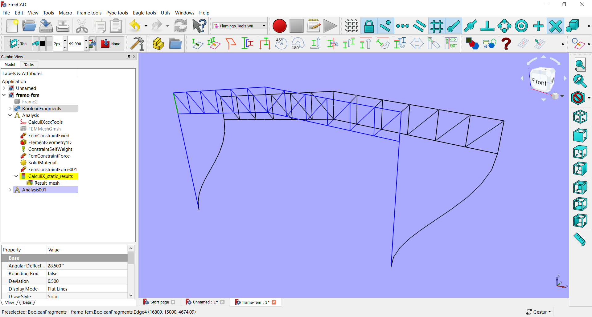

concretely what I want to get are the reactions in the supports and the moments in the sections, something like this:
I think this problem should be plane truss problem.
It can find only axial force in an element and can apply the only joint load at a node.
The link below has a python code for analyzing 2D Truss by matrix analysis method for truss, that can run on FreeCAD 0.17.xxxx
I will try to assign a portico problem with that code.
the working link … https://sukhbinder.wordpress.com/2015/02/10/analysing-trusses-a-python-program/
just give it a try … https://forum.freecadweb.org/viewtopic.php?f=18&t=22383#p175602
beam analysis is supported for some cross sections. If you manually edit the input file of ccx you can use real truss elements and any cross section. Post processing for beam element could be better, but you may use para view for this. Would be cool if someone does some development in the regard of beams and trusses in FreeCAD FEM, because everything is there …

I think, it would be great to be able to draw the free body diagram, and that from defining a section you can “develop” the volume of structural element. This would allow two things:
  • Simplify the modeling process
  • Perform simple calculations (such as a plane truss)
I understand that the problem would lie in the fact that the parts of a complex structure, such as a truss, dont link at one point, but at their sides/edges … so we would have to clarify which element “passes over another” .. but I think also when creating a mesh, is it from the object “as a whole” right?
Hi Hessed.
I use Ftool nearly every day, but when running your example I found out, that Ftool automatically generates
a mid-point at the diagonals. How to get rid of this behaviour? The diagonals should overlap, not
intersect. An idea to modell a plane truss problem in FC without any new programming is using a 2D-mesh
with facebinder-tool. As you can see in the Ftool-plots, the main force is the normal force in the truss-members.
Shear-force/bending moment is nearly zero (as expected).
In FC you can assign an arbitrary shell-thickness to each truss member for simulating the strain-stiffness along each truss.

and the complete structural scheme of what I want to do is:
some measurements may be wrong in the last images, because I take them from the teacher’s model
I have no idea how to do something similar to FTool in FC, besides that I would like to do it in 3D, with the corresponding sections, with the option to modify it in a general way in all the elements (no idea if this is even possible).
Line model of the factory, made by python scripting.

Thank you very much for your contributions, I really love this more and more.
@chakkree : As for the scrip, I still do not find the way, im trying copying the text and it does not work, neither downloading the file that you attached and dragging it to the Py console. I get this error:
… Msg(dataNodes); Msg(‘\n’)
File “”, line 2
IndentationError: unexpected indent
@bernd : Regarding this, I am studying your file to see if I can decipher how you did it, it does not seem complicated at all, but to me is requiring reverse engineering to understand it haha. with what tools did you draw it?
Last : (again, i dont know if this its the right place to this but since we are..) i try Flamingo as Yorik told me, and apparently it is not possible to insert PNC in adjacent lines that share direction, in the following image it is seen how I had to stretch the upper cord to be able to join it to the right side cord (and the same should be done with the columns, which only extend to the truss, and not even the support on the ground itself) you think that this can affect how the structure is considered during the calculation ? Excuse me for asking something that is surely silly, but I still dont understand very well how it works.
I used one of chakkree frames, extracted the edges and used Part → BooleanFragments to put them together. All the rest ist normal FEM in FreeCAD …
Bernd
@Bernd Wow! :astonished:
I’m very interest in this.
I will try to analyze like this with FEM WB.
