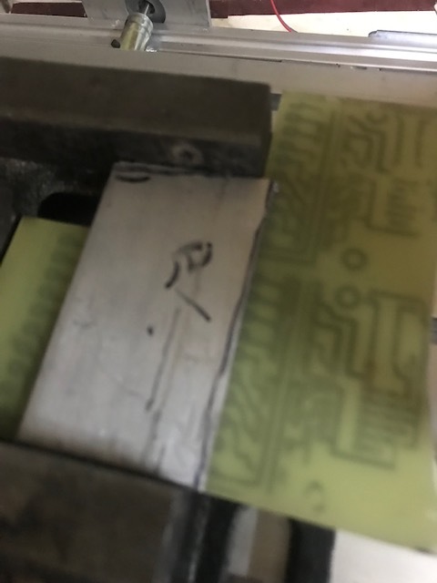

Finaly i just want to make the hole side straid. But this dont work. on they other side i have fixing so i can not surounding.

Unfortunately your second request is again unclear to me. I seems that you want to machine an existing part but you do not want to perform a contouring path due to conflicting existing features. Is that correct?
Either way we will need more detailed descriptions of what you want to achieve and your constraints to help you better.

Finaly i just want to make this side straight.

You have two options, one is you can use the operation Deburr which allows you to specify a single edge for processing and an offset from that edge. It’s a bit tricky but if you search this forum you’ll find pointers on how to do it.
The other option is to upgrade to the very latest development branch. A feature was merged yesterday which allows you to add “Extensions” to PocketShape operations. With that you can make that little socket wide enough so Path generates a path for it.
Ok. Thank you for your help.
Sorry, both ways i didnt succeed. I just copy the G-Code into to the machine and did it manual
