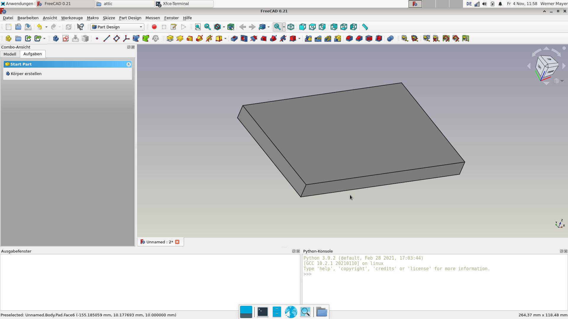

Here is a screenshot of a FreeCAD build using Qt6:
There are a couple of problems that we have to master:
  • We explicitly use QtCore_MOC_EXECUTABLE for a handful of files. The variable is set to the content of
${Qt${FREECAD_QT_MAJOR_VERSION}Core_MOC_EXECUTABLE}
but because Qt6Core_MOC_EXECUTABLE is not defined QtCore_MOC_EXECUTABLE will be empty and causes a build failure. I had to manually create the CMake variable Qt6Core_MOC_EXECUTABLE and set the path to moc
  • The compiler produces a couple of dozens of warnings. Nothing serious and everything is easy to fix.
  • TechDraw is the only module that is not yet ported. This will be the most difficult part.
  • When starting FreeCAD the first time it has crashed immediately after showing the splash screen. This is because some modules import PySide2 modules which pull in Qt5 binaries and thus causes the crash. So, we need a mechanism where PySide2 calls are redirected to PySide6. Therefore we can use the same trick as we did with PySide vs. PySide2
  • Closing FreeCAD causes another crash. That should be easy to fix.
