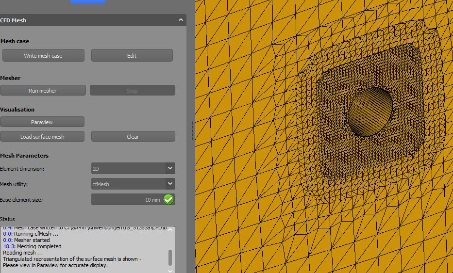

just doing some simple exercises, and not getting any satisfactory results. I’m trying to do a very simple cylinder-in-flow benchmark; 500mmx400mmx10mm volume with a 10mm radius cylinder:
meshing 2d cfmesh, base element size 10mm, with a mesh refinement of 0.1 relative on the cylinder surface. It’s turning the cad into a truncated mesh:
Any ideas what I’m doing wrong? (attaching the freecad file)
Many thanks for any pointers - it’s probably something really basic…

Looks like you need to decrease the base element size to prevent cells being lost. 4mm works for me. Alternatively making the geometry thicker in the z direction should allow you to use a coarser mesh without the cells disappearing.
Hi,
I use 1/3 of the part thickness as max element size for 2D-mesh (cfmesh only).
As oliver said: increase the part thickness or reduce max element size.

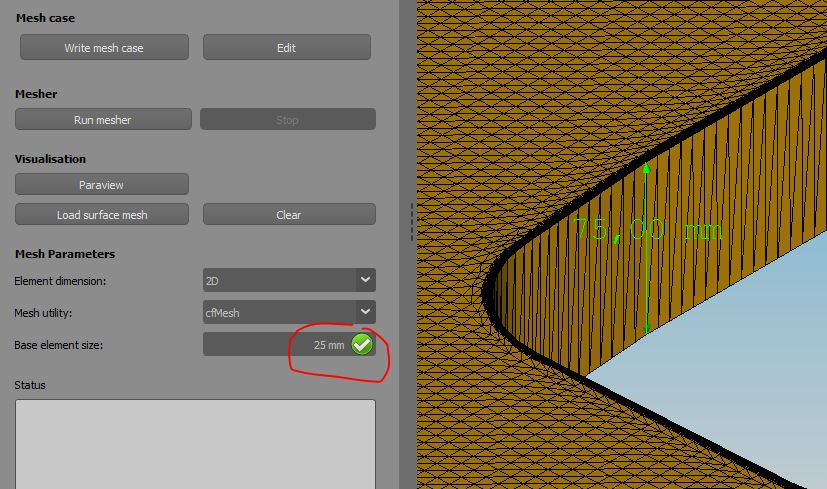

Hi all,
not having much luck now - reinstalled everything (freecad 0.18.3 from standard Ubuntu rep, OpenFoam7 from https://openfoam.org/download/7-ubuntu/, cfdof directly from addon manager, then cfmesh and hisa from there). Still not getting expected behaviour;
becomes
Any more thoughts?

Apologies. I introduced a horrible bug during code cleanup… Please update CfdOF and all should be well.

Just updated cfdof-wb, used “tester”-file from Kailee71, works with
