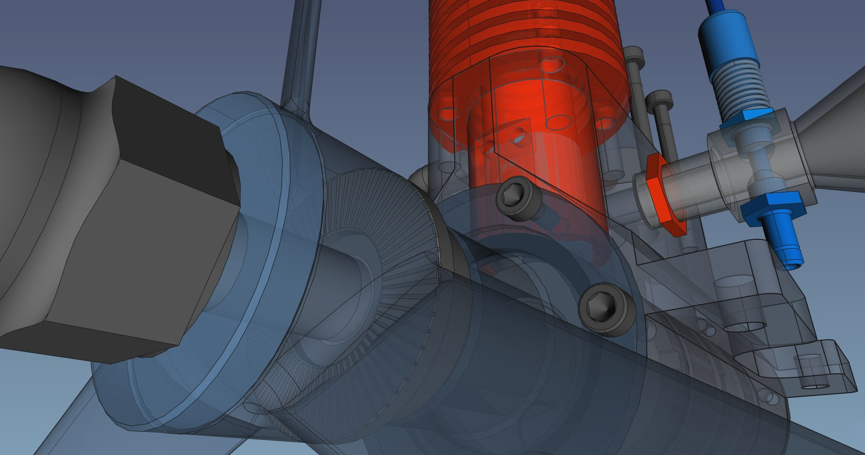

@Yorik do you have a larger version of the screenshot you used for the splash screen? I like to update the facebook page picture to match the splash, but the one in this thread has too low resolution.
+1, I wanted to ask the same thing for the FreeCAD Mastodon account ![]()
The file is here
