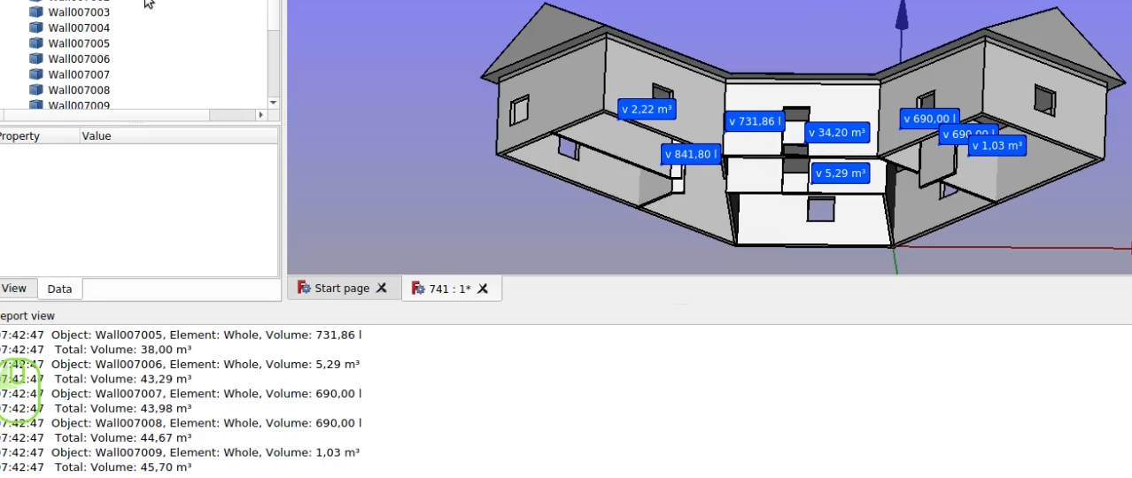

here is an example of using freecad to calculate volumes and areas and then creating an ifc file with the results (without attributes in the part names)
https://www.youtube.com/watch?v=wotlH68lg5o

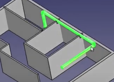

here is an example of a slot/breakthrough test with ifc
https://www.youtube.com/watch?v=PvuntXCoErA

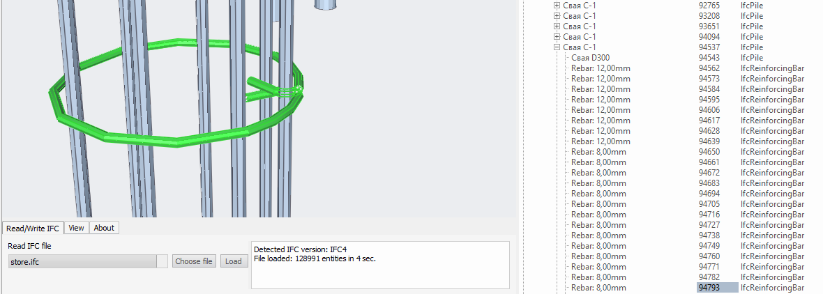

here is an example of a difficult ifc file,
https://grabcad.com/library/convenience-store-1
even commercial programs have problems displaying all geometries (here the reinforcement steel). ifcplusplus
https://github.com/ifcquery/ifcplusplus/releases/tag/1.1
opens the file very quickly and can display it. ifcconvert can quickly convert it to obj and freecad can edit it in detail with high performance.
https://www.youtube.com/watch?v=XSUmlo8vZZk

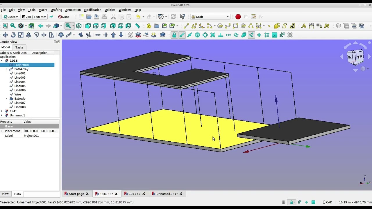

create in one second 2D “cut” from e.g. IFC file
https://www.youtube.com/watch?v=5z79eEDWISM
