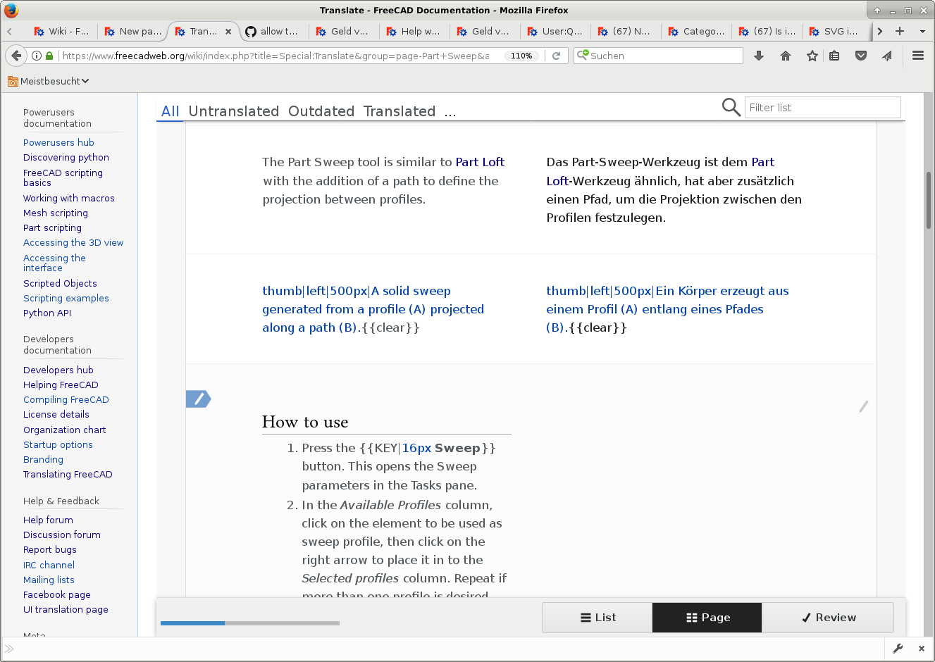

I just made changes to the Part Sweep page, and was trying to translate it in French (Part Sweep). In translation unit 16 which is a new unit, I’m getting the error
Échec de l’enregistrement de la traduction : This namespace is reserved for content page translations. The page you are trying to edit does not seem to correspond any page marked for translation.
This sucks, big time. :imp:
EDIT: closed the Translation page, opened it again… My translation for unit 16 is now gone. I was annoyed, now I’m pissed. :imp:

I am having no problems to translate https://www.freecadweb.org/wiki/Part_Sweep/de .
But the translation page looks different, as I did remember from the past. I can not see the numbers of the translation parts. Do you use the translation menu, in order to change something?

As I posted, the problem was only with translation unit 16, which is “How to use”. I just checked https://www.freecadweb.org/wiki/Part_Sweep/de, and you have not translated that section. It’s labeled Translations:Part Sweep/16/de. To translate it, you need to click somewhere on the section you want to translate. Then you get the translation window.
There is no problem with entering text, the problem is that it is not recorded. In the Page view, once you click on the Record button (whatever it is called in your language), the translated column to the right stays yellow. When you edit it again, that’s when you see the error shown in renatorivo’s screen capture, not before.
But I just tried again the French translation, and now it worked! :confused:
The translation unit number appears when you click on it, see renatorivo’s screen capture.
Your screenshot shows you are in Page mode, maybe you remember the List mode which the black button to the left at the bottom of the page.

I’m getting the namespace error again on an existing page I added translation units to. All the new translation units have this error.
PartDesign Revolution
I waited 24 hours and tried again to translate the page, still the same issue.
EDIT: I was able to fix this by making minor changes to the new translation units in the original English page, then marking the page for translation again. This time I was able to translate the new translation units.
