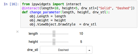

Hmm actual this are only 5 lines of code… Everyone with a compatible jupyter freecad combination can try this. But as I have said, dependencies are the difficult part.
But:
Although dependencies are quite difficult, I think jupyter is a really great way to interact with freecad. Writing a little graphical interface could be as easy as adding a little decorator:

Imagine you have a cad-model in freecad and you want to run a simulation on that model. Now this simulation produces much data which you want to show in some nice custom graphs. Jupyter can be used as a tool to visualize this data (plots, graphics, tables..). Also its nice to document all the stuff with some markdown.
Freecad objects could be represented in jupyter as 2d and 3d visualisations using jupyters rich representation.
