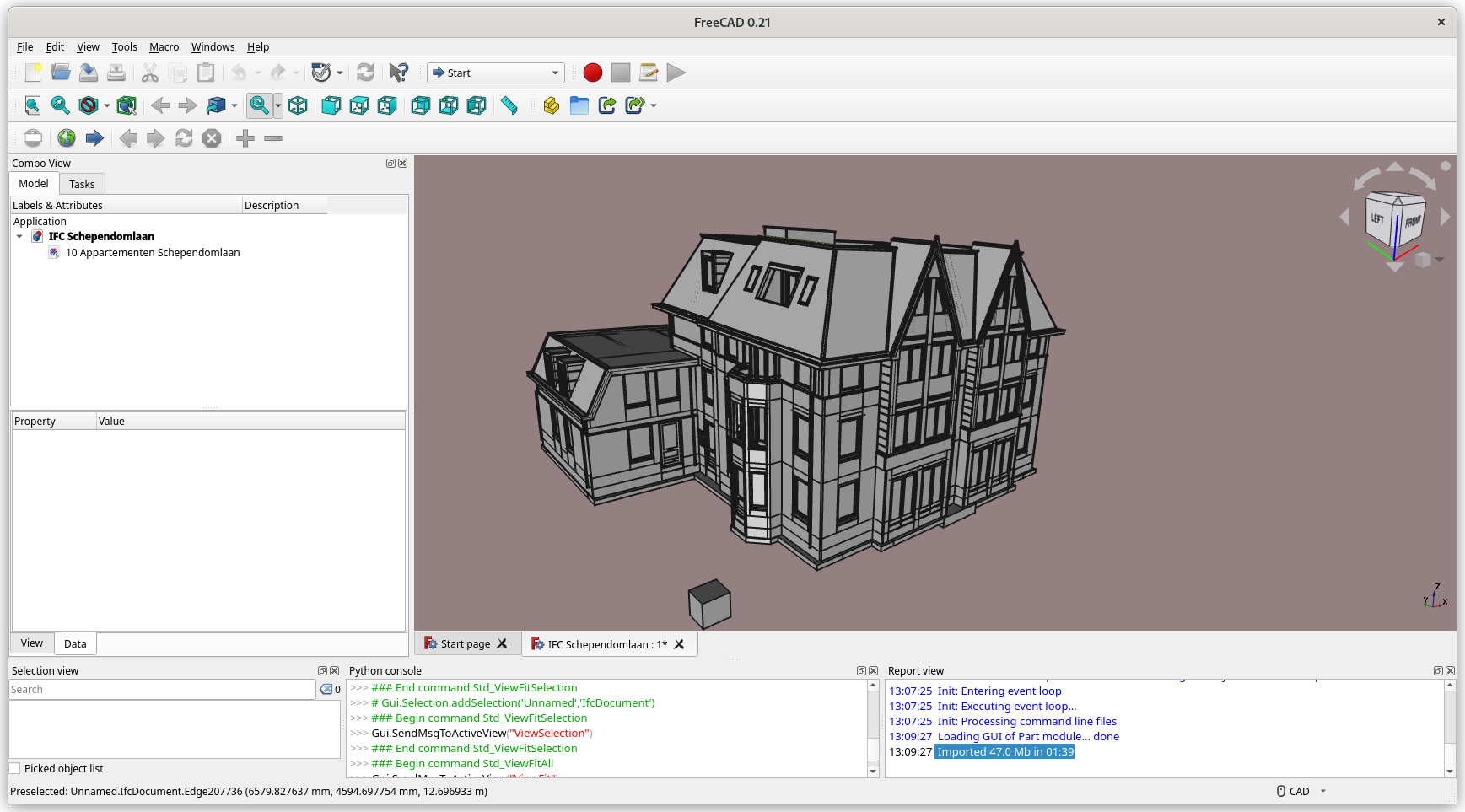

Tested latest commits with geometry import :slight_smile:
  1. schependomlaan.ifc of 47Mb imports (not sure if multi-core is enabled on my i3) in 01:39
  2. nothing shows up to “Select the BlenderBIM importer (bb_import)”, just have *.ifc in the ‘File of type’ in dialog box.
  3. saved FC file is about 13Mb (can’t upload, too big still)

Yes that’s normal. After you select an IFC file and press OK, you should see a pop up window asking you which importer to use.
On mine (ryzen9) it takes 23 seconds. There are 16 cores… Try this in python to know? import multicore; multicore.cpu_count()
Yes that will quickly be a problem… I have several ideas to try, maybe this should behave like the Arch Reference object, where you can choose either to save the shape, or not, or only the coin representation? I also want to try and see if there is any load time difference if we only load mesh data (no shape).

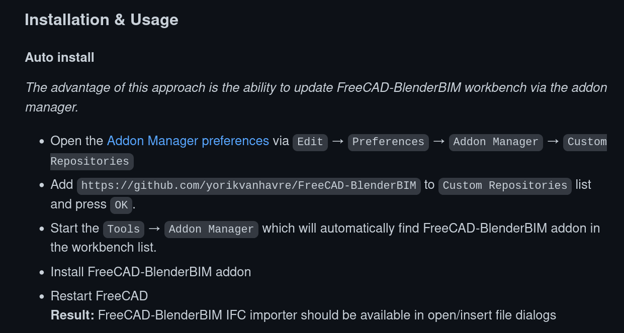

I’d like to test NativeIFC by installing via the splendid Addon_manager, but in the instruction on GitHub there is no branch name to insert in the preferences of the custom repos, I have an error.

Double clicking on the URL opens a dialog that allows me to specify the branch name:
OS: Ubuntu Core 20 (KDE/plasma)
Version: 0.21.30711 (Git) Snap 375
Hash: 916891c3fc1855b210e826825c235d8c96b78456
Python 3.8.10, Qt 5.15.5, Coin 4.0.0, Vtk 7.1.1, OCC 7.6.3
Thanks!
So that page on GitHub I think sould be updated inserting “main” as a branch name.
Good point. Will do that now.
Edit: added in https://github.com/yorikvanhavre/FreeCAD-BlenderBIM/commit/0f7dc217805fc56af7840ebda78dab414f0b1cef
