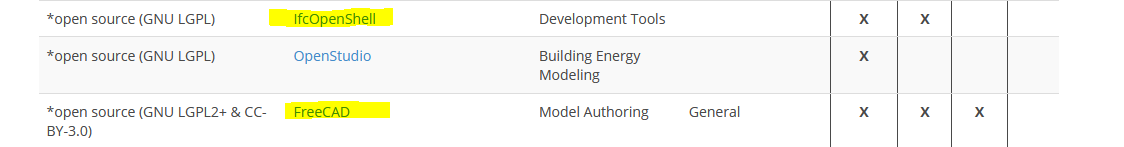

I got a first answer …
… Please check if the program is listed in the buildingSMART International Standards Implementation Database.
BIMcollab ZOOM should support files made in any of the programs in this list.
To my surprise either FreeCAD and IfcOpenShell are on the list :smiley:. Hopefully this wil convince them …
Before assuming it is a problem with zoom, we should check it first. The BlenderBIM add-on can help isolate issues. Jesusbill would you like to investigate? There were a number of issues already mentioned, perhaps those should be fixed first? Sorry I haven’t had time to investigate myself.

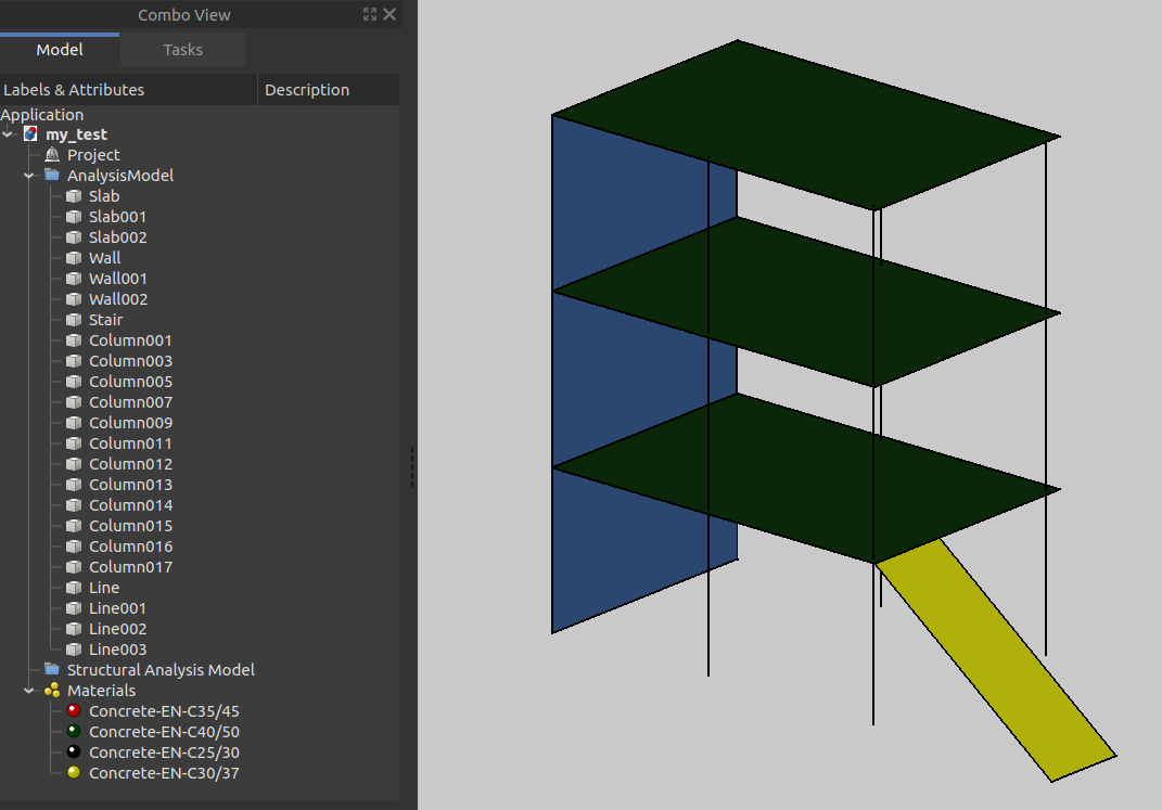

This is my usual FreeCad model with different materials and its (for now) created IFC file (only structure):
Cheers
test_structure_with_stairs_SurfaceMember.ifc (27.3 KB)

out of curiosity I imported my generated IFC file back into FreeCAD using the option “import_struct_IFC_objects=non_parametric_Arch_objects”.
The result looks amazing (material colors were corrected by me. I’m not writing them to IFC so obviously they could not be imported :smiley: )
BTW I noticed some minor issues:
  • surfaces thickness are all zero in the IFC attributes shown in the property panel
  • all structural properties of the imported materials are empty
Cheers
