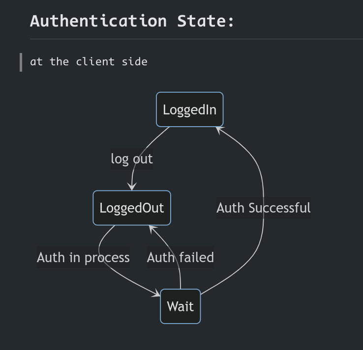

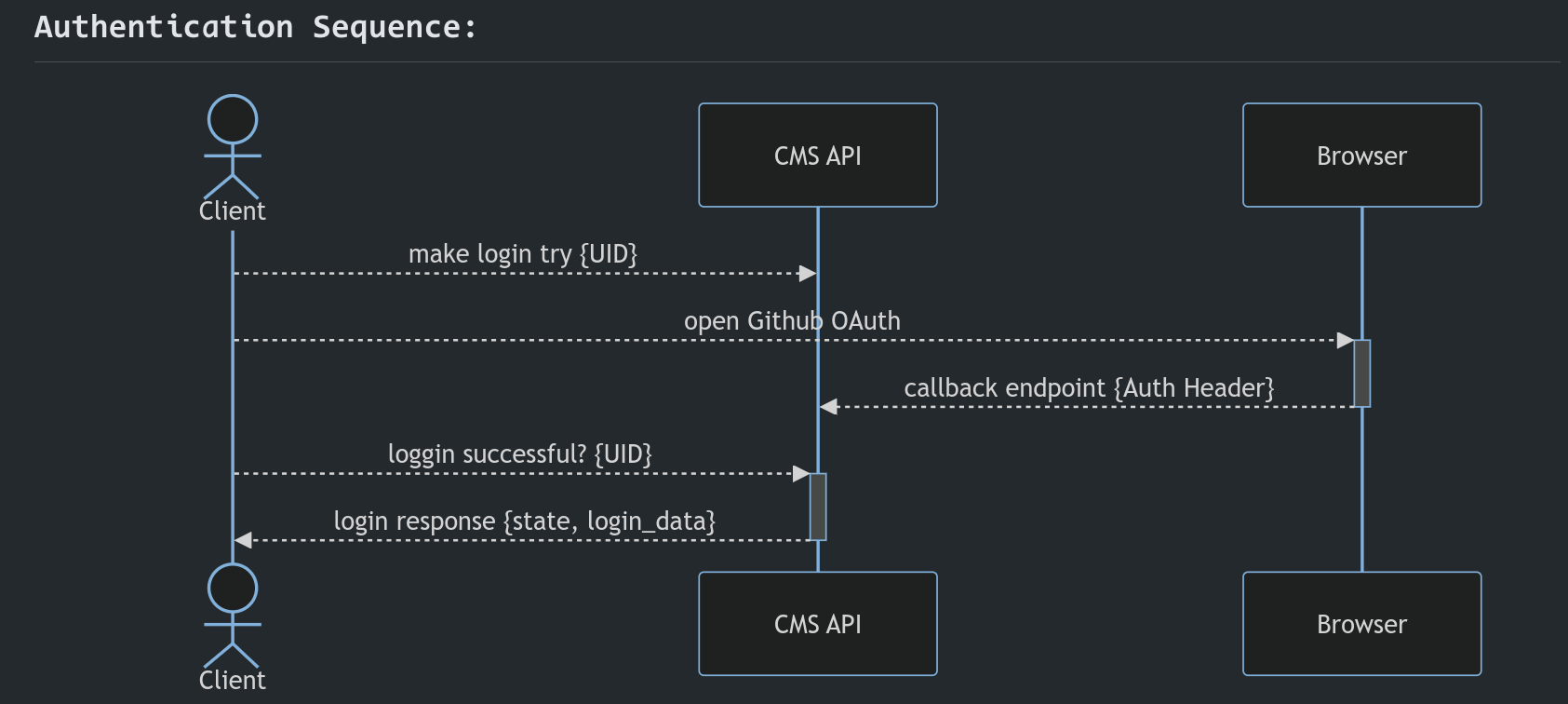

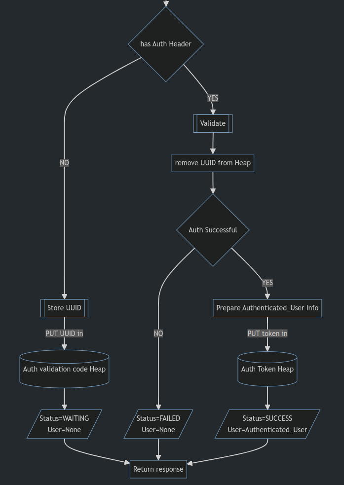

I am implementing authentication and authorization for the Component Management System.
Requirements:-
  1. basic user authentication
  2. allow the component owners to edit components
  3. admin controls
Available options that I am considering (kindly suggest other methods if applicable):-
  1. JWT (JSON Web Tokens) with id & password
  2. OAuth Providers
Points to consider:-
  1. For uploading a component, client need to use their personal github or a default github will be there if user do not wish to use personal github.
  2. uploading of component file will be done by the client once the metadata is created successfully by the API.
  3. even if the client wishes not to use personal github for uploading of components, the Authorization to edit is should be provided. This can be done by mapping the components with the user_id.
I am leaning towards Github OAuth. Reasons:-
  1. client already needs to interact with github for component uploading if they want to use personal github.
  2. Github OAuth is easy to use.
Issues in implementing Github OAuth (or any other OAuth I think):-
  1. It will use browser. We can either use User’s default local browser or QtWebengine.
  2. I have no experience with QtWebengine and I think it will be more tough to implement and time consuming.
  3. Using local browser has its own challenge, getting the auth-token back to the API for successful authentication. I have a solution designed for it which is illustrated below.
Kindly give your views kkremitzki chennes

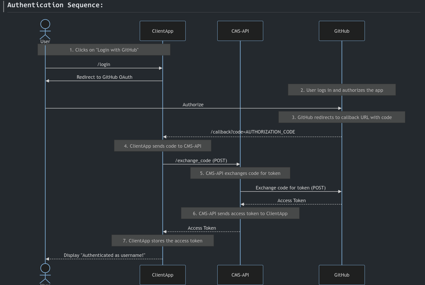

I did some research and have come up with the following flow:-
This new method uses the QtWebView rather than using the User’s Local Browser.
I am stuck in loading the addon in the freecad app. I have placed the repository with Init.py and InitGui.py in the Mod dir. I used a virtual env for the addon development and now when I try to load the addon in the freecad it shows xyz module not found. I know the modules have to be missing from the python env that freecad is using but I am unable to find a way to do so.
