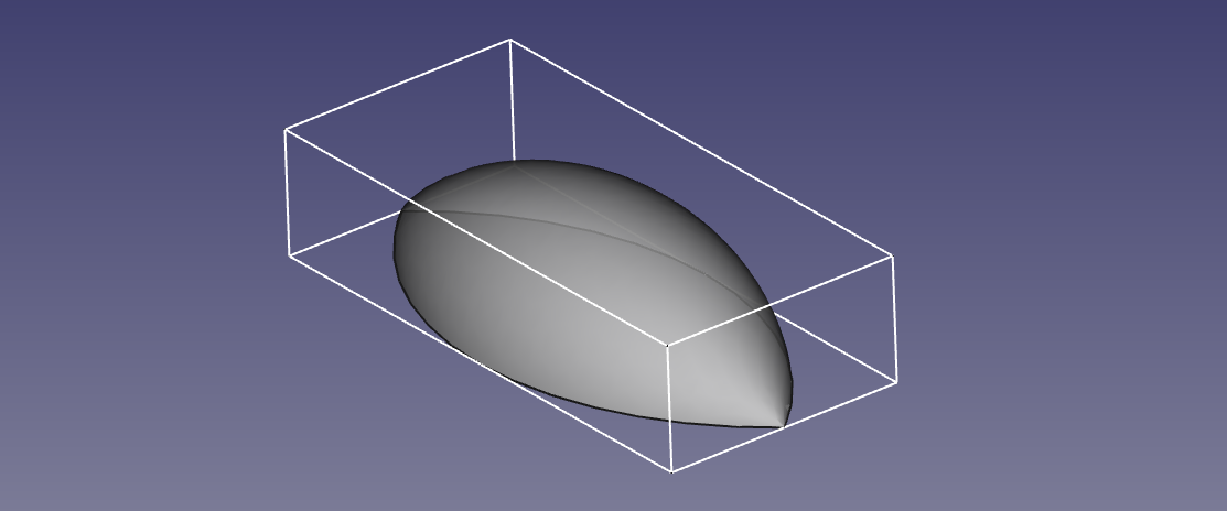

This isn’t totally correct. Here’s an example: a shape with two faces and two edges. Good luck figuring out, which edge is the edge between Face1 and Face2. Because both are.
toponaming-from-faces-problem.FCStd (7.69 KB)
For most practical purposes, it’ll probably work; we have to live with this idea, because OCC algorithms only give out the information about face inheritance (for solids).
I am not really sure what I am looking at here. Where are the two faces? Where are the two edges? Can either of these edges be filleted or chamfered? Or are they simply seam edges? If they are seam edges, then why would you need a reference to it?
Please excuse my ignorance. I obviously do not have as much experience with these things as some of you veterans here.
There is a model attached.
Does it matter? Fillet and chamfer are not the only thing which wants an edge. An external geometry in sketcher needs one, and assembly constraint needs one…
They are not seam edges.
Ah, sorry I was viewing on my phone I missed that. This is actually a really great example - as you’ve pointed out, the basic approach I’ve outlined would stumble here. But then again, the approach I’ve outlined is intended to solve the naming problem for primitive solids and their derivatives, thus I believe that expecting to have two face per given edge is reasonable.
That’s not to say that my naming framework is useless in this ‘sweep’ situation. In fact, I believe that my framework would still work - in the case of your revolved sketch an additional “revolved shape manager” (i’ll call it) will need to be created. The job of this RevolvedShapeManager will be to keep track of generated/modified/deleted Faces in the same way that some of the occ helper classes do.
For example, in the case of this revolved shape, the RevolvedShapeManager will need to keep track of the edges that make up the sketch that is revolved, the revolve axis, and the degree of revolution. If any of these changes, RevolvedShapeManager will have to provide a list of modified/added/deleted faces.
In your particular example, RevolvedShapeManager can go one step further: since the degree of revolution is 180 and the revolve-axis is coincident with an edge on the sketch, it can treat the two edges that you mention as a single edge. It only makes sense to do this when these two conditions are met, otherwise the two edges really are two distinct edges.
So, once the RevolvedShapeManager as been written, we can go back to using the regular ol’ SolidNamer as I outlined earlier.
But, my plan is to take this one step at a time. Start with the primitive solids and their derivatives (fuse, etc..), move on to extruded sketches, and finally go on to revolved and swept sketches.
