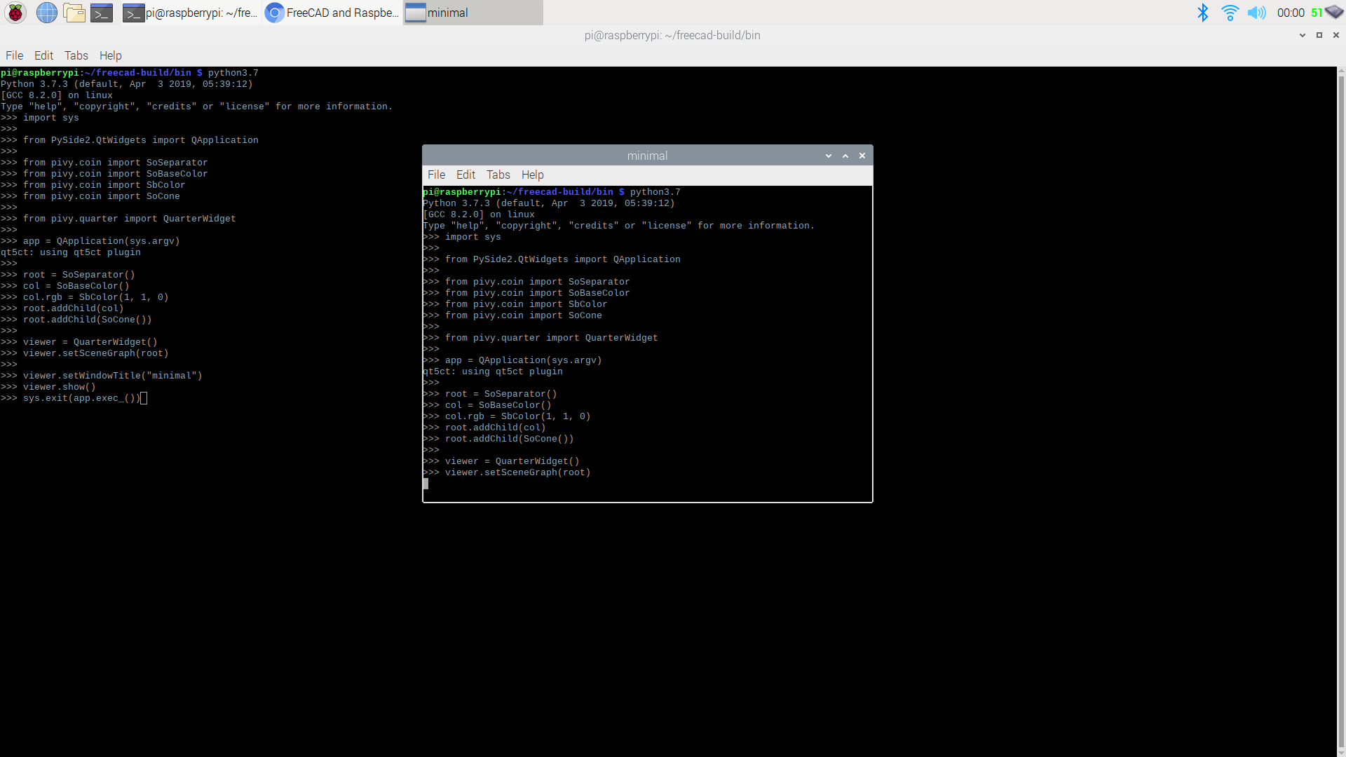

Well, this way it could be tested outside of FreeCAD to see if Coin3d works as expected. But Debian should already offer the python3-pivy package that provides all needed files so that there is no point in re-compiling yourself – unless these packages of your Debian version are still broken.
Anyway, here is a Python3 example to check if it also crashes or displays the scene:
import sys
from PySide2.QtWidgets import QApplication
from pivy.coin import SoSeparator
from pivy.coin import SoBaseColor
from pivy.coin import SbColor
from pivy.coin import SoCone
from pivy.quarter import QuarterWidget
app = QApplication(sys.argv)
root = SoSeparator()
col = SoBaseColor()
col.rgb = SbColor(1, 1, 0)
root.addChild(col)
root.addChild(SoCone())
viewer = QuarterWidget()
viewer.setSceneGraph(root)
viewer.setWindowTitle("minimal")
viewer.show()
sys.exit(app.exec_())
Ok, sorry, but I had to do this:
sudo cmake -DBUILD_QT5=ON     -DPYTHON_EXECUTABLE=/usr/bin/python3.7    DCMAKE_BUILD_TYPE=Debug  -DPYTHON_INCLUDE_DIR=/usr/include/python3.7m     -DPYTHON_LIBRARY=/usr/lib/arm-linux-gnueabihf/libpython3.7m.so     -DPYTHON_PACKAGES_PATH=/usr/local/lib/python3.7/dist-packages/     ../freecad-source
(if no sudo and those compiling options I’ve got errors during cmake. Don’t ask me why, if I remember I’ve found those instructions from Freecad compile documentation page. I used it as a workaround to my troubles. I don’t paste errors here, maybe offtopic, but I could if you would).
Then sudo make (otherwise it does not compile):
sudo make -j4

Thank you for the tips Werner, I’ve got a window with the scene:
It seems ok isn’t it? So now… any idea? :slight_smile:
Does this Quarter widget show a cone? From your screenshot I cannot see that.
