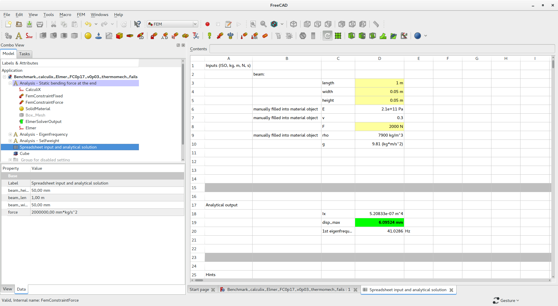

m42kus and I tried to elaborate some benchmark models for easier comparison between calculix and Elmer results.
Attached you find your first attempt. The results for static analysis, eigenfrequency and self-weight already be compared between Calculix, Elmer and analytics in the spreadsheet while the thermo-mech model gives wrong results in Elmer.
Benchmark_calculix_Elmer_FC0p17_v0p03_thermomech_fails.fcstd (109 KB)
I will update this file as soon as we have a solution for the thermomech. prob. or some more models.

I did a quick test and tried to load one of our vtk files but even when selecting to import the results only the mesh is shown. I will post such file later on.
