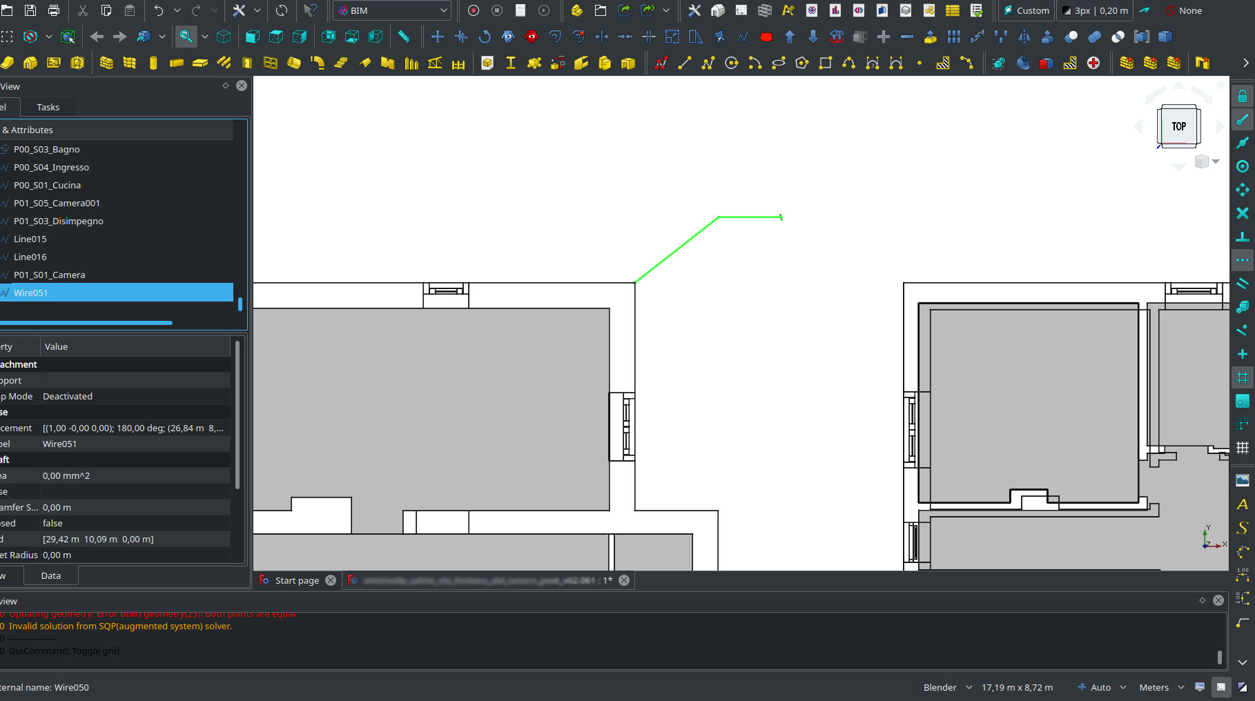

I know, but Hatch new tool it’s present (not working perfectly - angle rotation it’s still buggy -, but it’s a game changer, very very cool!), ok (in Arch), but the others are not there, or at least I cannot find it (I’m using Freecad Daily, so the latest version every day). I.e. as said, the (AMAZING) idea of the background color switch, how can be activated in BIMwb?
I cannot find the new measure annotation tool horizontal e vertical. Where are these tools? :unamused:
Still cannot see any new tool in BIM, rather then new (super cool) Hatch tool (in Arch). IE: where is the background color switch?
I’m using the FC-Daily. Maybe these features commented in the last Yorik message are not merged or are a proposal?
do you mean that here?
Nope, i mean this (not only this, there a lot of new feature list, some are present, but a lot not present):
You need to upgrade the BIM WB… See Std_AddonMgr.
Oh my gosh! :laughing:
I’m really stupid, it was so easy and logic, thanks a lot Roy! :smiley:
