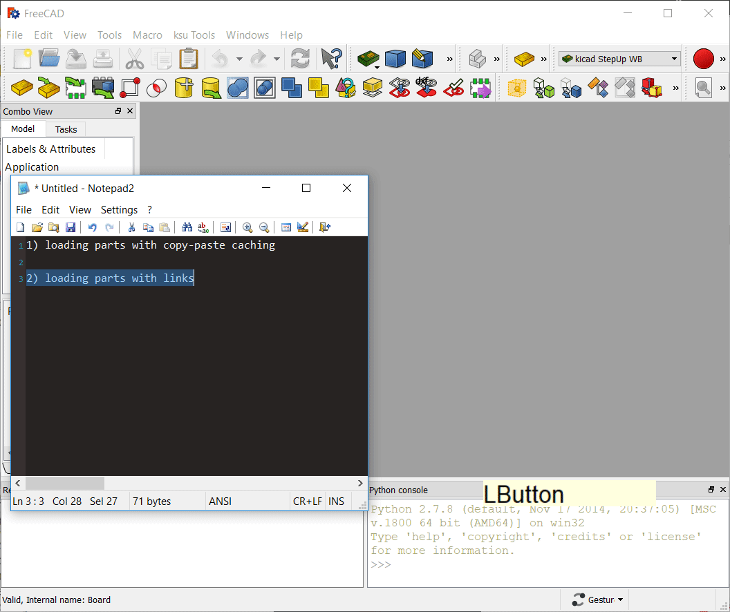

here a simple comparison between loading a board with 50pcs of the same switch with:
  1. the old method (using a copy-paste chaching)
  2. the new method with Assembly Links
No need to say a word! :smiley:
  1. old one
  2. new with Links

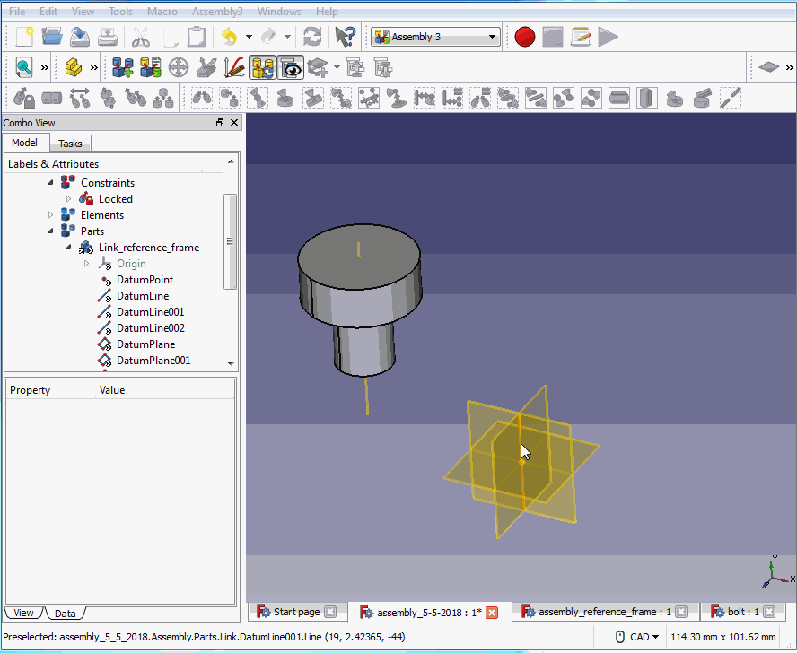

Hi Realthunder, or anyone else who is running the preview that might be able to help.
I’m having some problems getting basic constraints to do what I think they should. I’ll post examples as separate messages in case it’s easier to answer that way.

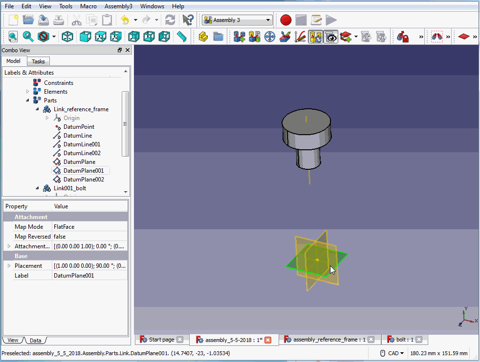

My first problem is-- the “lock” constraint doesn’t seem to really lock. Hopefully the screencast makes it clear what I mean. I select a plane in the “Link_reference_frame” part, hit the lock constraint, and am still able to move the part around.
The lock constraint is to prevent the solver to move the constrained part. You can of course manually move the part, which causes the solver to gather other movable parts around the newly located fixed part.
