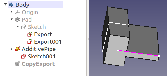

I have just done a rectangle, export two sides as single objects and pad it. Then I create another rectangle perpedicular to one of the exported sides. I wanted to make a sweep of the second rectangle along one of the exports.
When accepting the sweep, a “CopyExport” is created, even if the Export belongs to the same body.
I think the export functionality is a great idea.
That’s strange. Did you see any message box asking whether you want to create a clone? I can’t seem to reproduce it.
I have just tried again. I can not reproduce it either. I do not thing it was related to your branch.
I did get the dialog asking whether to create an independent copy, cross-link… This generally happens when you are using an object outside your body. But that was the only body, it was just a trial.

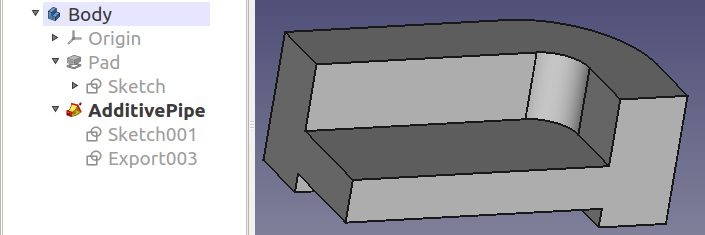

Anyway, it is really a beautiful feature. I filleted one corner of the original rectangle, and exported the contiguous “line-arc-line” as a single object. Then I sweeped a perpedicular profile along the export. The result is very nice with very little effort:
