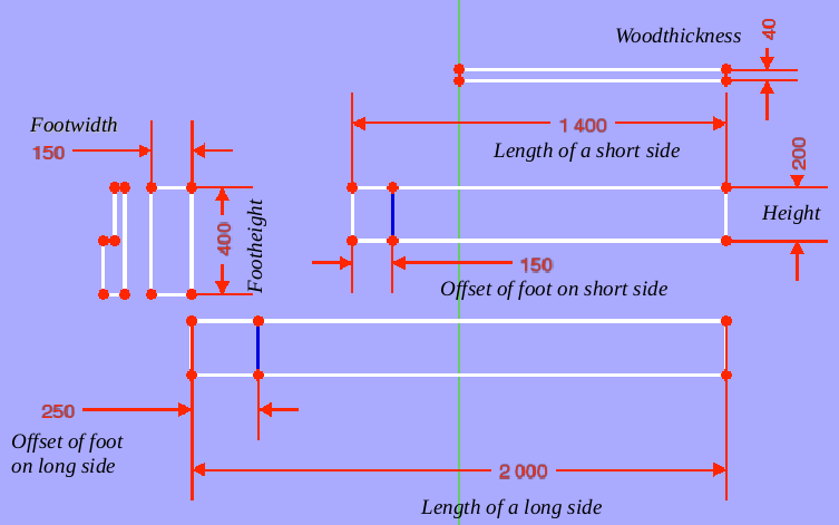

For fun I tried to make another version of the bed with Assembly 4. It was a good exercise for me especially since I tried to link all the LCS only to the sketches.
Everything is configured by the MasterSketch of which I attach a photo explaining the dimensions that can be modified.
If anyone is ever interested in explanations, I will complete the documentation especially regarding LCS.

Nice work, but I think you have overly complicated your life.
I don’t have the time to do it now, but you could try the following:
  • in a new file, create an Asm4 Model
  • in that same file, create 3 bodies Leg, Long_Side, Short_Side
  • create variables Length, Width, Height …
  • draw the 3 parts in PartDesign using the Variables where needed
  • create a MasterSketch in the Asm4 Model, and draw a rectangle using Length and Width from Variables
  • create another MasterSketch, import the previous rectangle, and draw some lines that will define the position of the legs
    (if you do it all in 1 sketch, you have a good chance to run into the toponaming issue)
  • create all necessary LCS, and attach them to the 2 MasterSketches
  • import de 3 bodies and place them onto the LCS
  • change the variables and check that everything moves as expected
ppemawm, what do you think, how would you do this ?
I would probably do the same as you suggest if, when you say “import the previous rectangle”, you mean Sketcher > carboncopy or external reference, and by “import 3 bodies” you mean assemble the links?

Here is a new solution for the bed following Zolko’s suggestion.
  • Compared to what Zolko suggested I only used one sketch because I do not understand where the topological naming issue could come from.
  • On the other hand, I had some problems with this sketch because I had initially used length, width and thickness of the wood. And when I changed the dimensions this thickeness “jumped” from the inside to the outside causing problems. This is why I then gave the inside and outside dimensions of the main rectangle (for example width and width -2 * thickness).
  • With this method I had to introduce eight LCS for the legs, that’s a lot. Was there a way to use transformations (symetry, rotation) on links in order to avoid to use such a lot of LCS ?
If wanted and if you find that interesting, I can try to write something in order to explain/compare the three methods.
@Zolko : sorry for your computer !
Zolko_Suggestion_Bed.FCStd (52.5 KB)
from there:
That’s the TNP in action. You found another solution to it, well done
