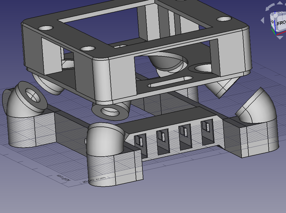

This is housing for dupont-like connectors
Here I have a mode of a holder for such housing
Yup is a pocket features galore in a ball.
Here it is used 4 times in an array in target body
Here is the real thing
I would very much like to have the “housing holder” maker in a separate file so I can use it it multiple projects. ASM4 natively supports having parts/bodies in other files right now, however I think it probably is not meant for my usecase.

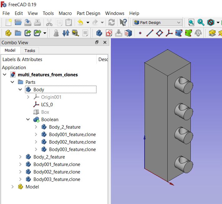

You can if you create the feature to be reused in a separate body and then use PartDesign (PD) > Boolean to either fuse (add) or cut (subtract). You can also clone the feature for multiple use, locate as desired, and add/subtract by the PD boolean tool to a body or multiple bodies. This is fully parametric since any change in the feature body will be reflected in the boolean.
You can also use Draft > Array to your heart’s content, drop it in a separate body as a base feature, and add/subtract using the PD boolean tool.
The body feature can also be saved in a separate file and merged when needed but there is no link. AFAIK there is no way to add a linked body to another body using the PD boolean tool, but I rarely use links so not too familiar with how they function.
multi_features_from_clones.FCStd (233 KB)

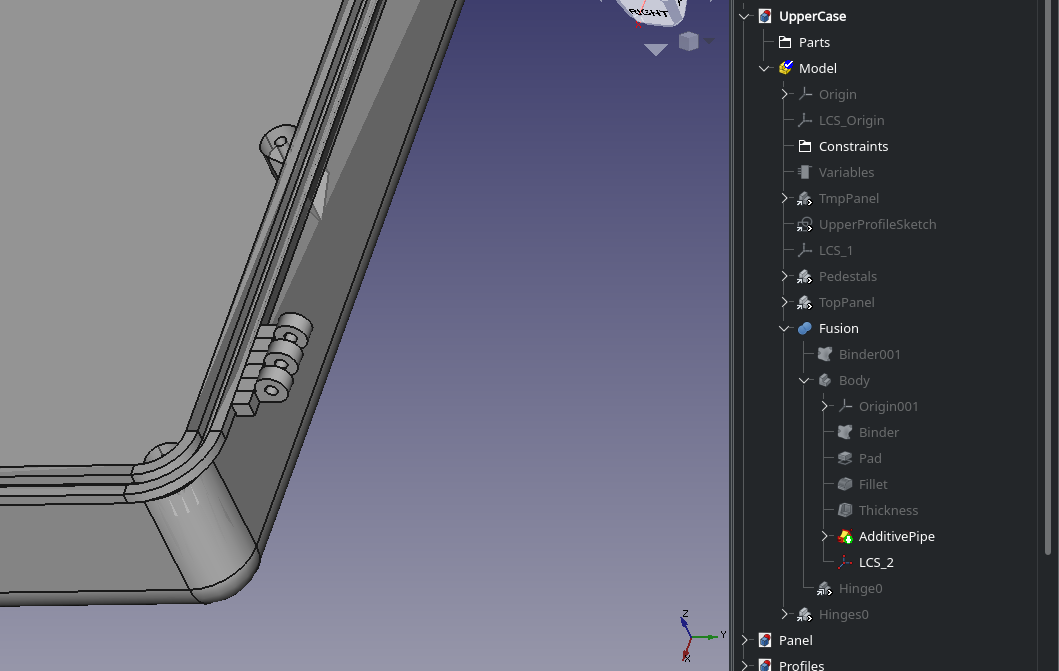

Right now I’m modelling a box/case.
Here I have a model of hinges:
Here I place them next to the upper part of the box… i.e. the Hinges0 Link.
And here is just the lower part fused to the rest of the box via Hinge0 SubLink.
I’m so happy right now.
