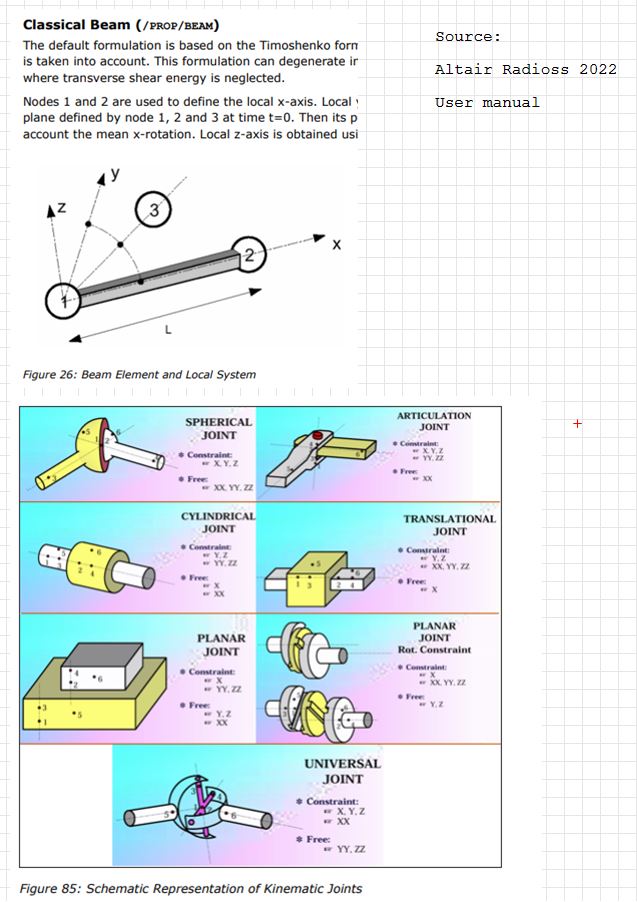

I had a look at the Altair Radioss User Documentation:
https://openradioss.atlassian.net/wiki/spaces/OPENRADIOSS/pages/4816906/OpenRadioss+User+Documentation
On page 93+137 is the description of beam-elements and hinges.
A implementation in FC+Windows would be very cool, thats what I miss
for calculating structures like this:
https://forum.freecadweb.org/viewtopic.php?f=18&t=61036&start=170
